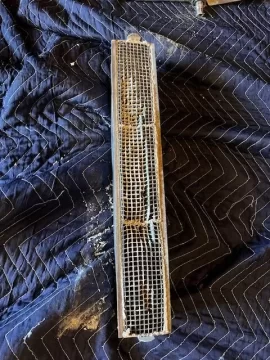

Hi everyone,
I have been a long-time reader of this forum. Today I finally registered an account and provide an update on the CI 2700. I got it installed in November 2022 and burned it all almost every day last winter. Last week I had it serviced and cleaned. The bad news is that the Cat is damaged and there is a small crack in the welding on the top right back corner. See the pictures below. The dealer is very helpful and working on it to get the unit replaced under warranty.
Hopefully, I can get a higher heat output from the new replacement. Last winter it could only keep the installed room at the lower 70s. The room beside it is usually in the 60s. I know I did not have the perfect wood, because it is impossible for me to get in the first burning season. I brought three cords of “fully seasoned” wood that claimed to be left from the season at the end of last winter, and stacked, covering the top with tarp. Right now, I can see the checks cracks on the end grain, and the discoloration (outside moisture level is 7, some do not show a value, besides the OAK is 11). I hope I will have much better wood for next winter. When the installer comes to replace the unit, I will ask them to install a block-off plate and do some insulation around the unit. By the way, my installer said he will make a block-off plate with an aluminum coil and put roxul around the unit. Is it an acceptable way to do it? I read it is recommended to use steel and rigid insulation?
I do not have any issues starting the fire. The top-down method works every time. I do not have issues maintaining the Cat temp. And I got the blackened glass on the left and right bottom quarter portion (starts from the right bottom corner, and the right portion is usually larger than the left portion). But when I let it burn with damp fully open, the black thing is burned off with only a little bit left in the bottom corners. And I get coals to start a fire in the morning.
The only issue I had is that the flame is still very high after I put the damp all the way to the right. And sometimes the secondary burn is shooting into the Cat, making it grows without the bypass rod being pushed in.

Hi everyone,

Thank you for your reply. Could you please provide an insight into why the CAT and firebox were damaged in the first season? What should I do to prevent this in the future?

Has anyone else who purchased a ci2700 in 2022 had an issue with their catalyst burning up after 1 season? My stove was installed in the summer of 2022 so I only operated it for one winter. I followed the operating instructions pretty strictly, burned seasoned oak, ash, and some birch, kept the damper mostly closed (especially overnight), and never burned with the door open except when first starting a fire or reloading.
I spoke with my installer and they processed the catalyst warranty through Regency for me. They said that they've had other customers in the past year with a similar issue and wondered whether the Regency catalyst on the newer stoves is defective since apparently they no longer ask for pictures when processing the warranty replacements.
How did the cat fail? Was there visible degradation like StevenY's cat?
Is the insert connected to a 6" stainless liner? How tall is the liner?
Yeah, it was visibly degraded and crumbling. I believe the liner is 6" diameter and roughly 20 ft long. I opted to have the installer wrap it with an insulation kit as was recommended on here.
