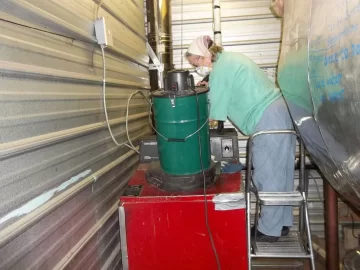

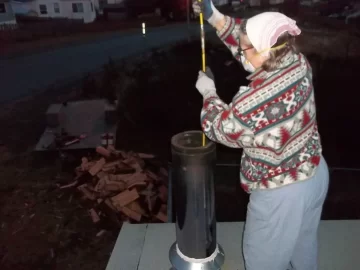

I'm recovering from laser Prostate surgery , so my bride of 42 years ( known as Woodwidow on another forum) cleaned the boiler and chimney for me on the weekend!

Hobby....I hope you are feeling great and healing even better! And what a trooper to do the work for you!
