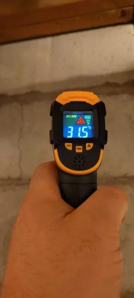

This is as hot as the masonry gets after hours (all day today and all day yesterday) of burning. That's not even 90 F, and it's right above where the elbow goes in.
I just fail to see how that would matter for any of the wood that might be near it. My average summertime attic temperature is way higher than that.

You are mistaken. This is the temperature of a wall actively being cooled by convection. What is the temperature of the wall that is bordering wood, that can't shed its heat?

I agree with you, but just a couple thoughts, if your temps at the flue collar on the stove are 600 - 800deg f how much of that heat is being shed from the non insulated liner into the masonry? Is it enough heat that during the mid stages of the burn that your flue gases are condensing and forming creosote towards the top of the liner and cap area?
Are you certain that there are no cracks or missing pieces of mortar in the chimney's clay liner to allow one spot to be hotter then another?
Chimney fires can hit or exceed temps of 2100 deg f, thats compromises the liner, the insulation buys time for you to leave the structure and call the fire dept for help.

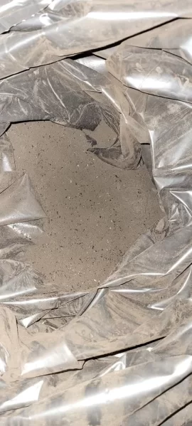

That's what everything that came off the last time I cleaned it looked like. It looks to me like 99% ash and soot, not creosote, but I'm not an expert.
That looks great.
