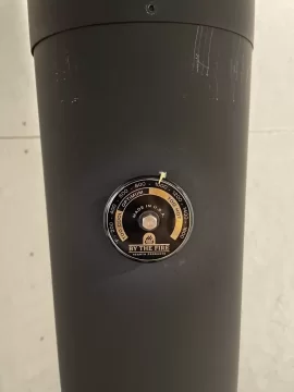

Sort of regret getting the ICC damper for 135$, when I could have drilled the chimney like you did.Just an FYI: here are a few pictures. They will give you a better idea of the holes I placed in my double wall stove pipe. The temp probe pic is the same size as my manometer hole.
I added fender washers and small pieces of sheet metal to cover the open area along the damper shaft in the first picture. I do not have a picture of the washers installed. Also visible in that picture is the inside of my temp probe hole.

Been running the stove with the damper closed full for 2 h.
So far:
- seems to run about 100F higher STT
- seems to use less wood
- I can let the stove run on high without the flue temps exceeding 900F
- For the first time, I’ve had to turn the stove down because it was too hot in the basement. Granted, it’s only -2C out.
Final remark: must remember to open the damper before I open the door to add a load in. Had the wife screaming that the house smelt like it was on fire, in no time
