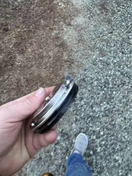

Possibly covering the intake. I have a jar lid that snaps perfectly into the 3.5” opening for the OAK.
