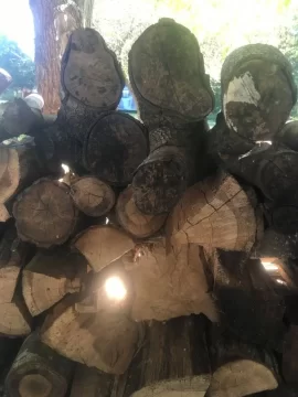

Ok so here is the picture of the wood I'm burning... I plan to get a meter, but do you guys think it looks like its seasoned enough? If not I'm going to have a hard time finding wood this year because this is what everyone is selling.

Without a meter the best test I know to do is to split the wood, lay the fresh cut piece against your cheek. If it is cool, it is likely wet, the coolness is water. Not very accurate, but a quick backyard answer. I was splitting this weekend and have been playing with a meter, so far I have been wrong on every piece I guessed at. I had a few pieces I would have sworn were dry (nice deep open cracks, felt dry, sounded dry hitting them togeather) and they were at the 22 plus moisture content.

A lot of that stuff looks like pretty big splits. My stove isn't happy with stuff like that unless it's good and dry and already hot. Re-splitting some of that stuff down may help since you'll have better air/surface area ratio. Won't be surprised if the rounds are not dry.

Was that wood bought, too? In order to get it below 20% moisture content it needs to be split and stacked in a spot with lots of sun and wind. It is rare to find a firewood seller who has the time and space to do that. Still, they often advertise their wood as "seasoned" because it has been sitting in logs on their yard before being split sometimes at the day of delivery. A moisture meter will give you a final answer. I am also with jatoxico that wood still in rounds dries very poorly (at least in my hands). I now split everything down to 2" diameter branches at least once before stacking.
Ok I will try this today
