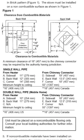

8 inches from stove 10 from pipe.
Your going to need to use double wall pipe. Add a couple 45s to get it away from the wall. Here is the requirements.
Oy, that is very close. The wall behind that pipe will be extremely hot when that stove is burning well for hours. The best solution is to change the stove pipe to double-wall stove pipe. It only requires 6" clearance. That will also improve draft a little. Another option is to install pipe shields on the pipe. These need to go right up to the the chimney support. This also will reduce clearance to 6".
http://www.amazon.com/Imperial-Group-BM0133-Adjustable-Shield/dp/B000DZQR3Q
Or the entire back wall could get a proper NFPA 211 wall shielding. This needs to be ventilated in the rear with a 1" gap to the wall. A hearthpad directly attached to the wall is not recognized protection.
The stove clearance is more of a problem, especially from an insurance standpoint because the stove manual doesn't list the option to use a wall shield. The minimum clearance is 12" with single wall pipe, 11" with double-wall. One option is to put an offset made of two 45 deg. elbows to bring the stove out from the wall to make it legal. I would do this high up to kick the stove pipe away from the wall as quickly as possible. The pipe, if it remains single-wall, will still need shielding at top for the elbow.
PS: If you bring the stove to proper clearance then the black wall pad is not helping anything. Actually it isn't doing much even now. If the stove is moved to the proper clearance you might be able to turn it and the current hearth pad sideways to make full coverage between the two pads. What size are they?
