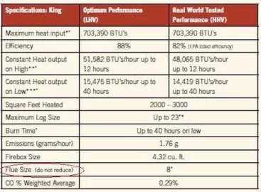

Reviewing the blaze king ''king'' online brochure if you look at the chart covering temperatures vs time at its slowest burning setting the flue temp does not go over about 160°F, it would then make it impossible at that temperature to heat up the OP's huge 25ft cinder block chimney and flue as he did with his previous RSF wood burners.
The other thing that bothers me is that on the brochure itself it states not to reduce the flue size below 8''. Refer to the block in the red oval at the bottom.
