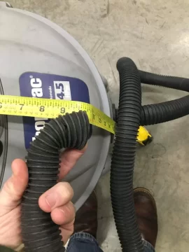

If your shop vac hose is one of the smaller ones and more flexible I’ve actually had success using no attachments, just the hose and flex it near 90 degrees to press it flat against the cat face. Don’t scrub the cat face but put a good suck on all the cells.
Maybe the 30 box doesn’t even allow enough space for that or maybe you use need a cheaper shop vac with less manly hose!
I’ve pulled cats several times for cleaning and inspection. It is a hassle and usually not worth it in my opinion. I ordered a new ceramic cat. Since the steel cat is fairly new I will probably clean it up and keep as a spare.
Ouch!
My shop vac hose may not be long but it sure is skinny!
I was totally talking about vacuuming a catalyst but I see what you’re saying.
"Less manly hose"? ;lol
I've tried it with two different hoses, one on my smaller shop vac (Ø1-7/8") and my ash vac (Ø1-1/4"?), and neither can bend tight enough to get at the face of the cat mounted in an Ashford 30. Maybe it's mounted higher above the door, or closer to the door frame?
Putting the automotive attachment on the shop vac will let you get at it well enough to resolve an emergency situation. But the few times I've done that have always resulted in me eventually removing the thing a few days later to give it a proper cleaning.
Less manly like my skinny 1.5” hose! It’s almost rubber like and flexible. I’ve had no problem getting a tight seal with it against the face of the cat.
If there was debris behind the cat in the dome you can suck that out through the bypass opening or suck it right through the cat.
