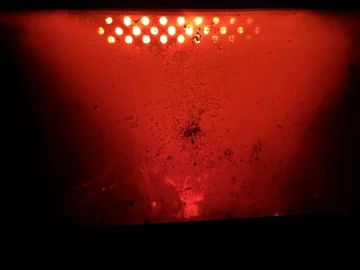

Thought the stoves cat was running a little sluggish, been noticing the cat probe needle apexing between noon and 1 o’clock then falling back and hanging at 10 o’clock or so for the past 2 burns, decided to check things out and see if I could do a quick fix, knowing that my wood is fully seasoned and hanging around 14%
1st I verified that the chimney cap was free and clear of debris
2nd I check to make sure my door gaskets was properly tensioned
Finding both fine and knowing that I ran the stove pretty hard during the cold snap around Xmas, I figured the cat needed a quick front face blow with compressed air (nothing more then 25 psi)
Did that and now running red again.
View attachment 307393 View attachment 307394
It’s a great feeling to do a quick fix like this. I only did a soft bristle brush run on my cat once (not burning full time). On my VC I had to do it once every two weeks. But as you found out, I knew exactly what the symptoms of sluggish cat were.
I did that once, thinking I could be neat and clean about it, with careful aim. But I was wrong, it made a mess! How'd you get away with it?
Ever since that incident, and knowing I can never really get it properly cleaned in place with the vacuum, I've settled for pulling it out for a cleaning, on occasions when it needs it. Of course, since adding a pipe damper and going to the ceramic cat, I haven't needed to do it very many times outside of the summer cleaning.
I was actually careful of that, I had hot coals going, bypass open, damper open and t stat open full, carefully blasted the cells only holding the nozzle parallel to the cat face, did stray upper left and had a small ash plume come at me, all in all very easy, I took longer to get the flame shield off / on then to hit the cat face with air.
The compressed air cans (think keyboards) is what I have used. No need for hoses, cords etc. For as seldom as I need it, one can last 2-3 years. (Unless grandkids find it...then about 3 minutes!)
I just cranked down the air compressor regulator to only put out 25 psi and then slipped a length of rubber vacuum hose over the blow gun nozzle. I could bend that vacuum line pretty sharp and get all the cells.
Of course, before blowing on the face I made sure to sweep the face off with the soft paint brush. That way you're not blowing more junk into the cells. Then have the bypass closed when blowing. So the debris all went into the cat chamber.
I guess I don't understand how this could be messy.
I don't do it anymore though with ceramics and my short chimney the cells don't pack up.
