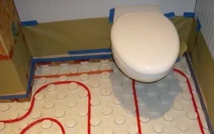

Heres a pic of my bathroom floor tubing. Note straight piece which I curved up wall to receive the floor sensor. Foam product is bekotec from Shluter which requires a mud setting bed for tile or maybe floating wood floor.
