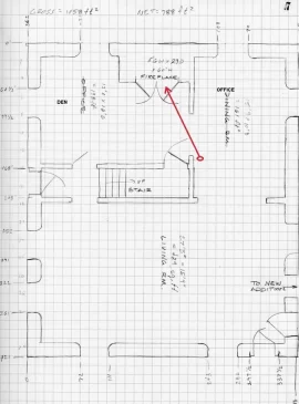

Already doing that, actually. See red fan and direction of flow in the sketch below. This is probably not as ideal as having a fan in the doorway at the foot of the stair pointed toward the stove, to force a CW rotational flow around the staircase, but there's just no way to put the fan in that doorway without it being a tripping hazard. With the fan it the location shown, it's completely out of our walking path.
[Hearth.com] The "pick Joful's new stove" thread!
So, we have a CCW flow around the staircase, and a good amount of heat does end up going up the staircase. That's good for reducing heat load upstairs, but bad for keeping our living room warm. Essentially, I'm trying to force all the heat thru a 36" wide doorway, whereas reversing the flow would give us a 56" doorway in the passive heatflow path. Oh well.
I did once have the fan below the window next to the doorway marked "to new addition", pointed in the direction of the stove. That worked maybe a bit better than where the fan is now, but my wife complained it felt too cold sitting at her desk in the office, since it was blowing sort of indirectly toward her.
I was thinking of a fan actually on the hearth, within the fireplace cavity, angled and pointing to the masonry behind the stove. I realize you would probably not want to do that permanently, but it might give you an idea of how direct air within the fireplace makes a difference (if any) in moving heat off the masonry and out of the cavity. So a bit different than the idea of moving cooler room air in the general direction of the stove; this would be closer to approximating the action of a blower, I would think.
That will sort of work, but the most efficient heat delivery is usually going to be blowing across the stove top from back to front.
Coming soon to hearth dot com, new thread, "help Joful locate fans on floorplan for convection currents."
It's a pretty common topic, experimentation is always in order. Just because one set of fan placement works good enough doesn't mean you can't make it better.
That's pretty much what my floor fan ends up doing: air hits the bottom of the back wall of the fireplace right behind the stove and flows up and out, across the stove top from back to front. First time I tried it I was blown away (almost literally) by how much hot air came flowing out of the fireplace and into my face.
Yeah, I think that's what mine is already doing. It's less than 10 feet away, at it's current location.
Was thinking, try two feet, just for kicks. See if you can feel a difference standing in front of the stove.
Jotul, my fan on my insert runs 24/7 @ 3000rpms so my heat goes into the room rather than heat my exterior chimney. I too have a small box fan on floor blowing cooler air toward stove. the door is 6 feet wide but has a 12" header and it still rolls right around it and up the stairs. So I would vote for a blower for your stove location.
