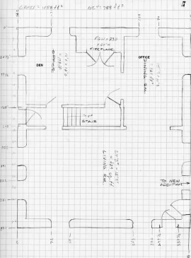

Begreen probably remembers this sketch from my first post on this forum, as he was the first to answer me on that day. The room labeled DEN is actually the original kitchen of this house, and that large fireplace is where I have one of my stoves.
[Hearth.com] The "pick Joful's new stove" thread!
This is the stove that's putting the larger dent in my heating bill, despite it being in a less than ideal location for air circulation. Yes, the Den is warm, and the Living Room gets cool without the central heat working. Yet, I'm still cutting my oil bill roughly in half with this arrangement (from $7000/yr. to $3500/yr.).
The primary heat loss is those thick stone walls, I suspect. They hold a constant 52F, this time of year, no matter how warm or cold it is in the house. Better in many ways than older framed construction, but obviously not on-par with today's latest.
So, in an arrangement like this, what is better. Convective? Radiant?

Radiant means "line-of-sight". If you can sit right in front of it, it will be better/nicer. Otherwise, I would go convective and even more so if the back of the fireplace goes to the outside.

You know I hate agreeing with you Grisu, but I think you're right on both points. The stove does back up to an outside wall, and I'm pumping quite a lot of heat into that wall with the Jotuls. I had made up heat shields, which I was going to space 1" off that wall as a reflector to reduce heat loss into the outside wall behind each of my stoves, but have not installed them yet. I do enjoy feeling the radiant heat coming off my Jotuls, but any stove with glass can push some radiant heat, right? I think most of my radiant heat off the other five sides of this iron box are going right into my stonework, and so there's a good argument that convective is better.

I have been chewing on the floorplan above overnight and thinking about the convection fans on my stove.
I think an A30 in that alcove with the fan kit not running is really going to have to work to put heat out into the room.
OTOH a regular box fan on the floor at the foot of the stairs sucking cold air from the living room floor and blowing it straight towards the stove alcove, with the optional fan kit on the A30 running MIGHT setup a clockwise convection loop around the stairwell that might do very well. Aesthetic cost is a box fan on the floor just inside the front door, and the not too bad sound of the fan kit on the A30 running.
There is a quick sketch of my floorplan in this post: https://www.hearth.com/talk/threads/indoor-air-quality-hepa-filters.139980/#post-1881743
What I notice is when my wife is on the phone with the quiet child, my wife often turns the fan kit on the A30 off to hear just a little bit better. About 15-30 minutes later the air temp in the upstairs BRs and office is noticeably lower, even with the box fan on the floor in the hall pushing cold air along the floor towards the stove uninterrupted. In my little footprint I don't much care what speed the A30 fan kit is set too, as long as it is running.
