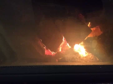

I just started my stove before piping in here with four splits and a fire starter. No other wood used and here's what my fire looks like and my stovetop temp.
Someone can correct me if I'm wrong but with your thermometer placement due to being an insert you are always going to be reading a bit cooler then what most people are referring to for stovetop temps. In my pic you can see how close my thermometer is to the flue.

Yes, you can burn slow and low with a tube stove. Just not as long or efficiently as with a cat. Here's the same load I posted earlier now, and the temp. I could easily cruise slow and low like this for quite awhile if I didn't desire more heat then I've already got. I will concede. Not as low and slow as a cat, or consistent. But to say you're wasting wood and can't burn low with a reburner/tube stove is not true.
[Hearth.com] Ready to Join The Gang - Time For a Wood Stove! [Hearth.com] Ready to Join The Gang - Time For a Wood Stove!
That's four pieces of wood with a fire starter I've burned so far. It's mild out. Low and slow, after the burn off. And I'm not worried about creosote or build up of any sort at all.
