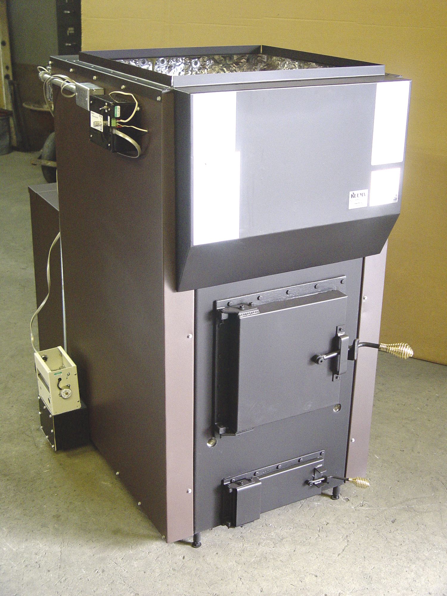

I meant to post this the other night and forgot...might help some new Kuuma owners figure out how much to load and not have too many coals left when you need to load before going to work in the morning...or running out of wood halfway through the night...and waking up to BRR! I have seen this several times over the years, but my google-fu brought up this article tonight when I searched for this data (just to be sure I had the numbers right)
Computer on low, is supposed to burn 3-4 lbs per hour.
Computer on med, is supposed to burn 5-7 lbs per hour.
Computer on high, is supposed to burn 8-9 lbs per hour.
