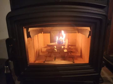

Well, it seems to be functioning well. Good draft and the stove responds well to control inputs. I did the 3 break in burns and tonight I am doing a full fledged burn under less than optimal outside temps(50F) just to test the draft. I also have a key damper ready to install if required. The plan now is to have an insulated liner installed in the spring just for the sake of longevity even if it is operating well at the moment.After the breakin, if the stove achieve good temperature and secondary combustion, then it should be good to go.
Yeah, I am worried with colder outdoor temps it will overdraft. I was surprised how quickly it heats up. I did a hot reload after the startup burn with larger kindling. I loaded 3 4-5in splits and it shot up to 800F on the center griddle within 15 minutes. The center griddle temp reads 100-150F hotter than the rest of the stove. I will definitely need to shut it down faster than I would have thought.Should be interesting how she works with a full load with your setup. Even if it’s a little warm out it’s good to test and burn the stink off while you can still open windows.
Looks like temps will finally be dropping here the next few days. Lately I’ve been just burning a fire in the evening. Looks like I’ll be 24/7 with 12 hour reloads for at least the next week.

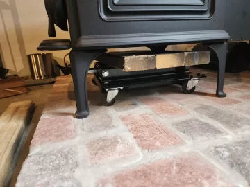

It is a relatively inexpensive motorcycle Jack I found on Amazon. I used the 2x4's from the stove shipping crate to keep from damaging the lower heat shield while lifting the stove. How should I go about drilling and installed the probe? Would you use any gasket cement? My concern would be only being able to apply it to the outer wall and no way to apply to the inner wall.That’s a slick looking Jack! An Auber probe would be a great tool to let you know what’s going on and when to turn your stove down. It may read a little high since you will have to install it close to the flue collar but it’s still worth the investment imo.
That's a beautiful sight. Congratulations.The stove is running wonderfully. The draft is more than adequate and the F45 itself is much more controllable than the Intrepid. It responds immediately to any control input. I just need to learn when to turn it down. I would like to install an auber probe into the DVL. Any advice on that account would be welcome.
That was the right way to do it. It needs to be supporting the frame. On some stoves like our heavy Alderlea this would not be possible because the ashpan hangs down like a belly below the sides of the firebox.It is a relatively inexpensive motorcycle Jack I found on Amazon. I used the 2x4's from the stove shipping crate to keep from damaging the lower heat shield while lifting the stove. How should I go about drilling and installed the probe? Would you use any gasket cement? My concern would be only being able to apply it to the outer wall and no way to apply to the inner wall.
I'm sure you could rig blocks to rest on the edge of the frame just like you would lift a car via the frame on a garage lift. A little ingenuity goes a long way.That's a beautiful sight. Congratulations.
![[Hearth.com] Jøtul F45 v2 install [Hearth.com] Jøtul F45 v2 install](https://www.hearth.com/talk/data/attachments/332/332334-95089ee18762b2346cdcdd88b213dcfa.jpg?hash=WQptPq7Soj)
I would just use the same size drill bit as the probe. You shouldn’t need any cement unless the hole is oversized.It is a relatively inexpensive motorcycle Jack I found on Amazon. I used the 2x4's from the stove shipping crate to keep from damaging the lower heat shield while lifting the stove. How should I go about drilling and installed the probe? Would you use any gasket cement? My concern would be only being able to apply it to the outer wall and no way to apply to the inner wall.
