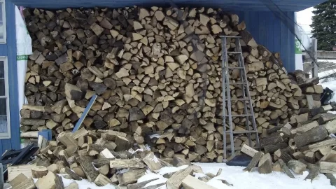

In January, I stacked 5 cord of maple and elm that I scored and split in November. 2 rows 10 ft high 22 ft wide. It has now hopelessly rolled over on me and needs to be taken out of the shed and then restacked. I have not experienced this before and the only difference I see is that it did not sit in the heap a year before being stacked.
So, how soon is too soon to stack if you don't have room to stack nicely spaced single rows no more than 4' high? While certainly not dry, it was already far from green.

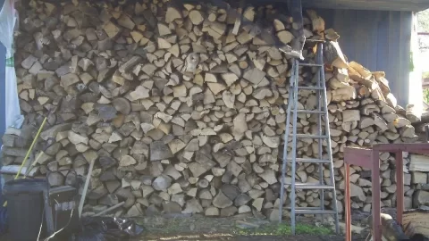

As for stacking in the shed on a concrete slab, my wood spends the first Summer on outdoor stacks and then gets restacked in the Fall. THere was a time I left the wood in heaps for the SUmmer and then stacked in the shed but with 9 1/2 foot tall stacks, they would suffer the same fate as yours if I didn't salt in long poles. Here's a pic of my stack showing some of the long E/W poles at about the 4 foot mark. You cannot really make out the N/S poles though in the pic.

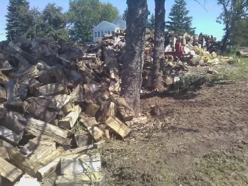

BTW, here is an example of what frost will do.
Yep, I can imagine what was uttered when you found that. This is what I am dealing with. The middle section is only a matter of time.

Actually, it didn't bother me nearly as much as when a stack of splits topples over. What bothered me a bit was the toppled rounds were sitting in standing water.
I like to buck up my wood in the Winter and then I stack it in the round until the snow is gone. I don't like to run my splitter in really cold weather nor do I like to sweat, so right around the time that pic was taken was when I was splitting.

3 months later and it hasn't moved. But, there is a chitload of compression on that 8' step ladder which is likely the only thing that has kept the whole stack from coming over. Almost makes me think 3 or 4 8 foot t-posts on the side of the stack would have prevented this.
