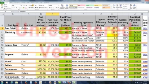

[Hearth.com] Got Propane? Using local prices here and the DOE fuel cost calculator, this is how the numbers crunch out in Michigan.

It's simple math to figure out fuel cost for any energy using appliance. It's all in btu's per hour and Efficiency rating. I've met with an electric company number cruncher and he told it like it was. And he showed the cost of the various gas or electric heaters too. It was for heating a insulated garage in Minnesota. But suspicion is good and they get it often I'm sure, lol
