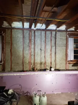

Finally got the spray foam done on the foundation sill plate. I got the 2 tank dow frothpak from lowes. Its my first time using this stuff and its really amazing product. So easy to spray and completely airseals and is r6 inch.
Its going to drop into the teens tonight so it will be interesting to see how it performs with the flir.

Its been a massive amount of work but I have all the insulation in and I am installing the drywall now. Was definitely worth it. The basement temps are significantly higher and are mostly around 60 degrees now. The most noticeable difference is how much warmer the floor above is now.

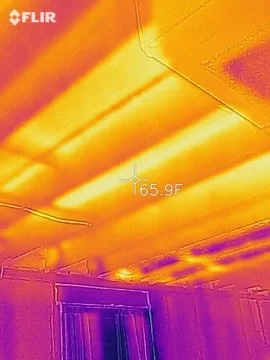

Here are some FLIR shots with just the insulation up. You can still see the heat loss soaking down through the floors and upper basement walls. Good visual of how heat will also travel down through colder floors. I might experiment with a section of basement ceiling with some mineral wool and see what it does.

Its been pretty mild here but we finally got some real cold. Its 11 degrees out and I just went out with the FLIR. I think I am going to go R20 and add another 2 inches of foamboard. My unfinished basement with no heat source has stayed around 50-55 all night which has been a massive improvement. It would drop to the 40s with similar temps before the insulation.
This FLIR shot still shows foundation temps in the mid 30's. Though that could be ground temps soaking in?
I have r20+ in the walls and the FLIR shows it as outside air temps when measured off the siding.
I am going to add another 2 inches of foamboard and will report back.

I was putting up board foam today and the wall temp was the same as the room temp .Uninsulated walls were 10 to 20 degrees colder then room temp.
I went outside this morning and shot the foundation again. I read a research paper that suggests the foundation actually wicks heat from the ground and that is what I was seeing. Its been pretty mild here and it makes sense as soil temperatures were still quite high.
Foundation was 17 this morning. All I can say is insulate your foundation if its not as the results have been beyond impressive.
