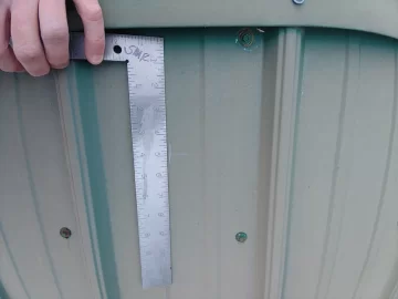

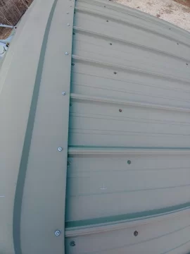

Like Begreen said, it’s no more risky than an asphalt shingled, or rubber roof. I’m a sheetmetal worker by trade and if you cut the flashing to fit the roof ribs as in the picture properly (not all hacked up) and use a good sealant (I’m partial to Solar Seal for this application) it shouldn’t ever leak.

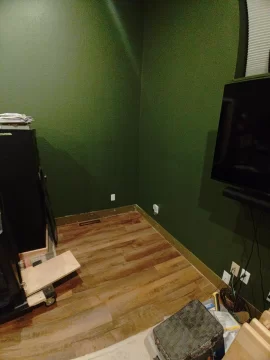

Well I'm back after a long couple of years on the road for work. Tonight I will get the new flooring removed in the hearth area and start the placement of the stove. 3 years of promise to the Misses ya know it's time now.

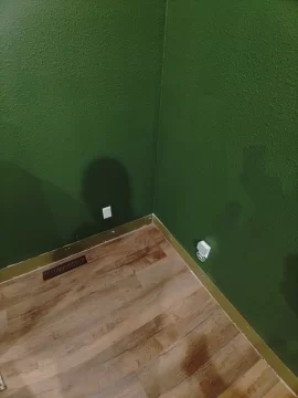

Looking for insight on these outlets that will interfere with the framing of the hearth and stone faced rear protection. I did read the Gwleo topic and that's the route I'm headed. I'll include the 1 inch air gap at the bottom of the hearth and same for the rear at the bottom and the top.
Could someone explain the 1 in air gap under the hearth please? Is it to be continuous or is it a volumetric calculation in the size of the openings for proper flow? Say 1-1/4" high x 4" long and 2 feet apart across the front of the hearth base.
We've got some warmish weather coming soon and try to avoid poking a hole in the roof in the freezing temps. Also, what to do with the outlets?

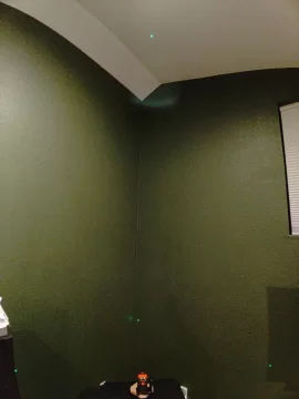

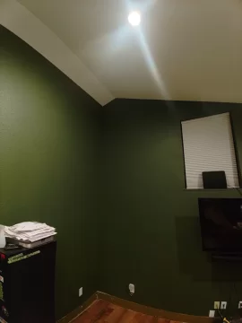

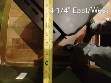

Here's the location of the stove in the corner. Praying not to hit the ridge with the stove placement or rafters in the cathedral ceiling and still be able to maintain the clearances.
  • [Hearth.com] Englander 32-NC: Earthbound home stability?
Typically, there is no air gap under the hearth pad (base?). It's only for the wall shielding. What is " the Gwleo topic"?
Looks like the hvac vent will need relocation.
I understand now that there's no need for breathability under the hearth pad. What about the wall shielding with the drywall behind it?
The member is Gwleo. He wrote a topic that's an Article here about building a hearth. See here:
The Vent is just for crawl space ventilation but it's slab on grade with 2x12 joists. I planned on sealing it up in lieu of this install.

If there is a need to reduce wall clearance to a permissible distance, then an NFPA 211 wall shield is the way to go. What is unclear is whether in your case it's necessary. Is this still for the 32NC? If yes, does it have the side shields? Will single or double-wall stove pipe be used to connect it? What is the planned distance for the stove corners to the drywall?

Reduction of wall clearance necessary? No, but in the event of contacting a roof truss I'm trying to avoid it. It looks as though it'll be 3 inches away from the truss above. Also, for insurance purposes I want to be as compliant as possible in Missouri as there's no real code inspection for my chimney in my area.
Is this for the 32NC? Yes
Side Shields? Yes
Stove pipe single or double wall? Double wall
Stove corner clearance to drywall? 9 inches to the calculated stone face of the wall shielding. I'm just trying to stay safe.

I have the side shields on my 32NC and set it to the clearances without any shields as per the placard. I don’t have any air gapped wall shielding and it is also a corner install. Single wall pipe as well. I believe you’re overthinking this.

It's best to break this project and communications into the two separate clearance issues. The stove pipe requirements (6") and the stove requirements (8" corner).
Provide more details on locating the support box and stove pipe clearance.
I'm probably overcomplicating it! Ha.
Yes, as described there is no need for a wall shielding system as long as double-walled stove pipe is used. For better support, there should be cement board instead of drywall. In that case, the studs behind the cement board are the nearest combustibles. There is no need to do metal studding or have an air gap behind the cement board in this circumstance.

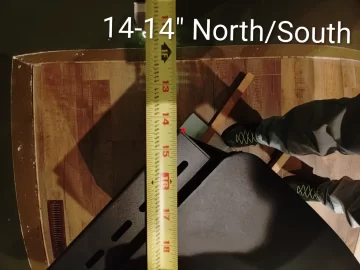

The height of the hearth will be raised 1-1/2" with Durock and an additional 3-5/8" with the 20 gauge steel stud framework under it and 1/2" thick ceramic tiles. Looks to be a raised height of 5-5/8" minimum. Not accounting for thinset mortar.

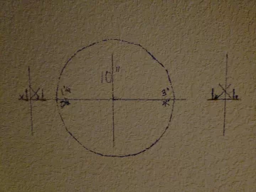

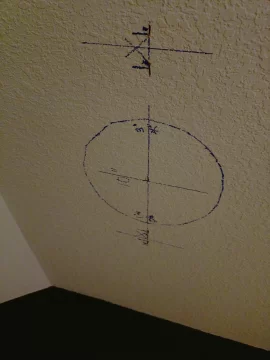

Rafters located above at 16" on center. I laid out the chimney location for ease of reference. Clearance to the rafters based on 10" diameter. Off to verify roof location at the ridge cap. Fingers crossed.

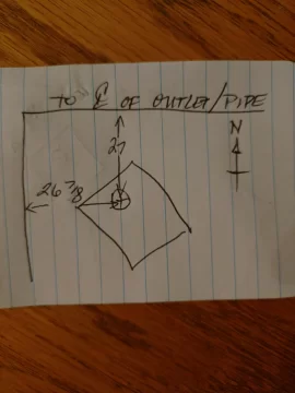

I didn't fall off the roof and here are the layout results. Approximately 53" from the facia to the centerline of the chimney penetration and 14-1/2" down from the ridge cap. Centerline of the chimney is 5" down from the edge of the ridge cap.

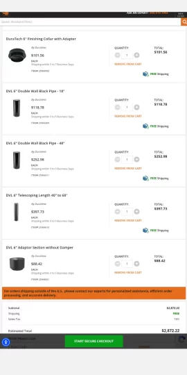

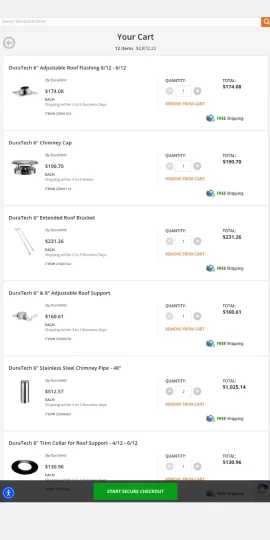

Is this list complete for install? I feel as though I'm missing something. I will order roof flashing from Excel per the recommendation of begreen earlier in this conversation.

The Duravent flashing will not be necessary if the Excel metal roof flashing will be used.

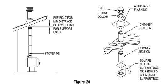

We need more details about the install but I am wondering if a short, cathedral ceiling support box wouldn't be better.

Is there a Ceiling Support Box required for install? I'm not opposed and am open to a complete component list so I can get it ordered. Thank you very much for the help thus far sir.
A cathedral ceiling support box gets hung between the rafters. It solves a couple issues because it can be hung plumb and is the trim + support, all in one. This is in lieu of the roof top support bracket, trim collar, and finishing collar.. Download the Duratech installation manual for more details. Note, the order is missing a storm collar. Also, save receipts. The DVL stove adapter is not needed for several stoves and a sloppy fit. In many cases the DVL pipe itself fits a lot better.
