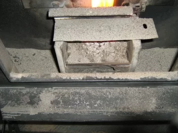

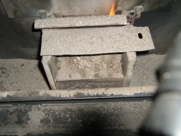

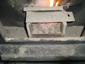

I had problems with pellets not burning completely and first blamed the different pellets I bought (not my first choice). Stove had been working OK with Somerset pellets so I thought the stove was clean enough. I put a restrictor plate on the burn pot which helped but this turned into a glowing mass that filled the burn pot and spilled over after about 5 hours. Decided to do a thorough cleanout but did notice the burn plate was not seated and had a gap at the front being held up by ash.
To test if this gap was the cause, I placed a nail under the burn plate and buildup of glowing, semi-burned pellets began advancing toward the edge of the burn pot. I didn't have to remove any ash I merely removed the nail to close the gap and the glowing mass receded and turned into light ash within an hour. The cleaning corrected the problem but the gap at the burn plate was apparently the prime cause.
[Hearth.com] Englander Burn Pot Build Up [Hearth.com] Englander Burn Pot Build Up [Hearth.com] Englander Burn Pot Build Up
With nail under the burn plate ----------- Buildup of Glowing Unburnt Pellets --- Half hour after nail removed
Pellets should not be pileing up like that.
The first thing I would check is that the control board is operating in the right mode.
There are lots of threads on this forum that discuss checking the operating mode, doing a control board reset and setting the operating mode. I believe that your stove should be in mode "C".
Once you are sure the board is in the right mode, check to see if there is a choke plate at the bottom of the hopper. You can reduce the pellet feed rate (coarse adjustment) by closing off the passage to the upper auger with that choke plate.
