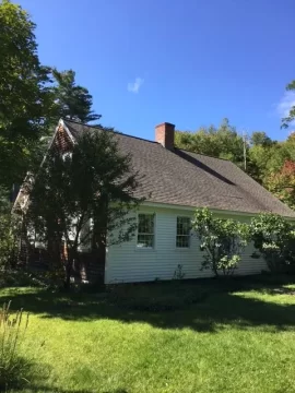

![[Hearth.com] Can I get the catalytic in an Encore to work with just a small fire? [Hearth.com] Can I get the catalytic in an Encore to work with just a small fire?](https://www.hearth.com/talk/data/attachments/221/221989-dc9a63176f2cf2758385e6b58aed85d4.jpg?hash=95Dh9Z7vBd)
Hopefully you'll be around for the next 10 yrs and as you get older you will appreciate the bone warming heat even more.
