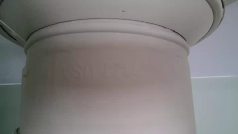

So I went up in the attic and the chimney has SuperVent wriiten on it which I see is the model of DSP made by Selkirk. So I should be able to order Selkirk DSP and just connect. Anyone know if an adapter is needed to fit to stove?
I would try it without an adapter. I am pretty sure the adapter was where my faint intermittent smell was coming from. You should be able to fit the DWSP over the stove collar so the inner layer of pipe is inside the stove collar, the outer layer outside the stove collar.
