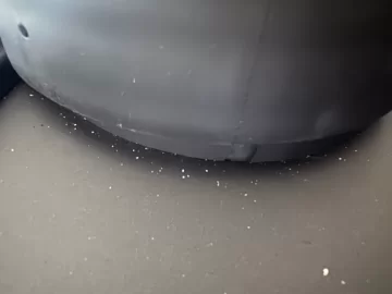

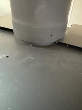

Ok still searching for potential areas of smoke smell. Is this pipe supposed to be sat all the way down? It’s also some what loose. I can move it around
That's fine. The outer wall of the double wall is shorter and you want the inner wall with the taper to bottom out to form the seal before the "skirt" hits the stove top which would hold the taper away from seating.

Yes I’ll grab some pictures shortly I’m away from the house now. But I did pull the pipe up and the double wall inner portion does not fit tightly inside the stove. The inside portion of the pipe is actually shorter than the outer wall that has the flare to it. I assuming that’s not correct?
You may need a adapter to fit into the stove first then the dw would go into the adapter. Check the stove pipe manufacturers website to see what's available

I was in contact with the installer he said he will make it right for me he may not have realized that those two raised areas of the stove prevent the pipe from seating all the way into the collar. He’s going to bring an adapter with him as well as we’re going to add a foot to the chimney just to be on the safe side since I’m at 15 ft( min. Required height.)
You want that taper to tighten up as you set it into the stove collar. Air leaks into the flue spoil draft.
Ok time for a long over due update sorry life had been crazy busy lately. Finally got the stove collar adapter in and I believe another 4 ft section of pipe was added and this thing is a completely different stove! In a good way. Cold starts are so much easier, and getting the Temp setting dialed in it’s way more flexible for me now. Before it was too hot or not enough. And best part is I’ve had no smoke smell whatsoever! Thanks everyone for your help! I’m loving this thing. Finally got cold enough to burn here in pa. Getting a good consistent 15 hour burn with temps in the low 20’s now just gotta dial in the new set up and learn the new stack height and I’ll be good to go!
