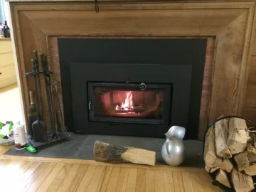

Hi all, my wife and I had the Regency CI2600 installed almost a week ago today. We ran the 6 or so small fires they ask to burn it in, and have since been trying all-day and overnight burns.
Before I get into how we're not seeing the results we expected, let me ask a question about the temps.
We got a thermometer from our dealer to affix to the stove, it's on a magnet. When I placed it on the stove, the needle never moved, so I stuck it on the stove door...the metal frame around the glass. Once I did that the needle shot right up. The temp NEVER reads over 400 though, in fact it shows a "best operation" zone from 300-450, and anything over 500 is in the "danger zone".
I see where some of you are talking about getting this thing up to 500 or 700, and wonder what we're doing wrong...is this thermometer supposed to be placed in a different spot? Our liner is fully inside the chimney, so the only place to stick it is on the door, the stove, or the shielding.
The thermometer that most of us have has a probe the goes inside the stove. The temps are next to the cat inside they can reach 1000+ easy.The thermometer you have won't be accurate. If you look at the manual I think it's page 34 you will see the correct thermometer you need. To get a good overnight burn you would have to load as much wood in as you can fit with a good bed of hot coals, also when you load not to many gaps put the wood all stacked up next to each other. If done correct you should fit about 7 to 9 pieces of wood. You need to hit temps between 500-700 to activate the cat (don't go by temp on your thermometer) if no thermometer when you see a nice flame take about 10 to 15 min then close the top that activates the cat wait about 30 sec then close the bottom. Don't forget to take one set top and bottom of washers off the lach (one set at a time every couple of days or the door won't close). I hope this helps.
Where did you get your wood? Is it kiln-dried? Otherwise, it does not looked seasoned; no cracks in the ends or any discoloration from the sun. Maybe that's part of the reason your results are unsatisfying.
