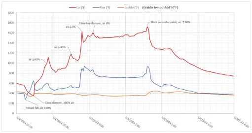

I did a cold start today and then once I had a decent bed of coals I did small, less than half load. It was two splits of solid ash and one piece that was kind of punky. It lit quick. My flue hit 800 in less than a minute and my cat is at 1400 within 30 minutes. I usually struggle to get my cat to 1100 from the first load of a cold start on a load this small.
The difference...this is the second time I've put a peice of punky wood in. The first time I did that was when my stove went nuclear on me.
Well the plan to stuff the stove got aborted. Got the pile about to where I had it last night and it caught…had to reload before the starter fire was burned down so there were a few chunks of coals in the way. Timing dictated it was reload now or not till tomorrow.
So we are gonna have a repeat from last night except this time the coals lit the new load front and center instead of back right corner.
Well let’s just say I bumped the alarm up to 1780 so it wouldn’t keep going off. Not sure if all the details but draft was the issue tonight. First part of the run went just like last night but cat kept creeping high and higher. Opening the secondary flapper didn’t even stop it from going to 1700. Nothing it did helped, opened the top door and used poker to collapse the load, tried burning more in the primary, the list goes on and on. Anyways when I opened the window by the stove the air started blasting through a 1” crack and within 30 seconds cat temp started dropping and within 3 mins dropped from 1700 to 1460.
And as I’m typing this it’s starting back up. Dang chicken bones…
Update. Back up to 1650 and back puffing. Must have a had a bad piece of wood in the pile. Yes there were two splits with bark on them, maple.
…it’s burns like this that makes me want to use this stove as a flower pot!
Final answer…
Cat at 1000 stt at 550, both coming down. Not sure if it was timing or draft related but I kicked on my hvac blower (it pressurizes the upstairs due to screwed up duct work) and my window quite sucking in air and stove lined out immediately. So was either a bad piece of wood or poor draft or both or neither…
Any how it’s cooling down now, won’t reload anymore tonight.
My stove hasn't been cold in quite a few days, just keep it rolling. Been able to have good coals and 5-600 cat temps on reloads. 3/4 box let it burn good and flip the damper cat rises to 1,000 turn the air back to maybe 10% open and sit back and relax. So far highest is in 1400's.
I do have a cracked glass, new glass in the shop waiting until next week when it supposed to warm up to put it in.
If I lived on a boat this stove would be sleeping with the fishes. Slept on the couch last night minding the stove..... ridiculous.
Typically closing down my key damper brings temps crashing down, not last night. I had to block the secondary air inlet completely when cat temps peaked at 1720....

My flue gets higher than yours at those cat temps. Is that because you have a key damper? You're running a metal cat now, right? Is that because of the metal cat?
I do not use the Auber, I have a Watlow controller with one alarm setting. Has been 1600, last night it got bumped up to 1700.....
I thought you had an Auber meter. Anyone with an Auber? What do you have your alarm settings at?
Last night cat went into the 1400's and rising just before bed so I checked on it and it stopped rising about 1480 and started back down. I went to bed and everything must have been OK. This morning cat was in the high 500's when I opened the air and it went into the high 800's. I reloaded, let it run to 1,000 and shut it down to 10%. It settled and then started rising into the 1400's. I'm drinking coffee near the stove and have been walking the tightrope with it trying to get maximum heat and not let the cat run away, it's in the teens here and I want some heat. Every time the cat temps drop I give it a little more air, temps rise and then settle. It's almost surreal how controllable the stove has been.
I do not think the key damper would have much effect on the flue temps, when it is full open (which is how I normally run it). Although my last mod a year or so ago I made a "seal" inside the stove pipe so I can get better shutoff. It seals around the OD of the damper disc so I can really shut the draft off. I posted some pics in last years thread.
Anyway... my point is that seal is a restriction in my pipe even with the damper full open so all else being equal my draft should be lower, maybe that is reducing my peak flue temps? Hard to say.....
The last 3 weeks I have been running the ceramic cat. I may go back to the the metal cat today, my general opinion is the metal cats are less hyperactive and I generally see lower peak cat temps with it. I think @Woodsplitter67 has made the same observations.
This behavior is really confounding (but typical over the last 10 years). I go weeks with the stove being predictable and controllable and then wham, the psychosis sets in.... So what changed?
- My control technique is the same so that's not it, clearly I am not compensating for something.....
- Over night temps are cooler here the last two days, maybe elevated draft?
- Wood? Same batch of wood I have been burning for over a month now. With the bark....haha
