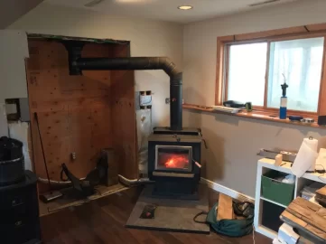

So I think we have been chasing this smoke smell the wrong way. I had it in a Ashford 30.1 and now a princess. Smoke smell shows up when T-Stat is being turned down. I also have excessive draft and I’m sure others do too. I was at .17 on high (checked though the cat temp probe hole). So I put a supervent flue damper on top of the stove, partly because it fit much better than the stove pipe adapter. Anyhow when dampening the flue down to the manufacture .05 limit the following are the results:
-no smoke smell
-no “V” shaped creosote stain on door
-burn durations as published
-much more visibly even fire at any T-stat position. Way Better.
So without dampening the flue all of the above it’s opposite. So would some of you with the smoke smell issue check the probe hole with a manometer please? Let’s see if you have a overdraft issue. I don’t think this is a BK stove issue more of a out of spec chimney doing to good of a job.
So why would a excessive pressure drop induced from the flue make migrate the smoke out of the stove? It’s sound backwards, I know.
So here is what is going on, I think. The pressure drop is the lowest the stove experiences during the entire burn when the T-stay is turned from full to medium/low. Think about it hot chimney pulling hard and the T-stat slams shut. The air gets stretched and instead of smoothly flowing off the airwash, following the glass down the air actually becomes turbulent at and departs the glass and tumbles and rolls in almost a straight line to the cat due to the extreme pressure drop. This is why when excessive draft exists the glass gets all black and the coals don’t burn down as well. When draft is in spec the glass stays clean, even on low and there is less coaling. The glass is getting dirty and the rope gasket is also getting soaked in smelly creosote cause the airwash isn’t doing it’s job because the air is getting pulled directly off the wash towards the center straight toward the cat which is why we get the dirty “V” shaped glass.
It also might be, under this condition the area outside of the “V” pattern could be under some high pressure due to turbulent air with some pulsing against the rope which is pushing the black creosote out though the rope.
These stoves on low or medium low let so little air though which is partly why they are so darn efficient. The issue I think is most of the chimneys we have even at room temperature will draft at .02-.03, with no extra heat. I think we’re blowing past the design parameters of the stove.
So why no smell on medium high (for most). Well pressure drop is higher in cruise at these settings but the CFM of air moving though the stove is double or triple what it is with the T-stat in the 2pm position. So the air moves faster and the airwash works mostly as intended.
To support this my glass stay cleaner at 2 o’clock position with the correct draft than on high with .17 draft? Make sense?
Also on high at excessive draft I would rip though a load of oak in 3 hours. Now on high it will run 6,7 or 8 hours which is closer to what BK advertises for heat output on high. How many of you have noticed the same thing? Slightly less heat out put now, but not much less, like 5-10% but twice as long of Burns.
Thoughts? So why am I getting so much draft? 1,300ft sea level super vent 6”, 21’, with 6’ of double wall insulated chimney in a framed enclosure. I think the class a insulated keeps more heat in the pipe as well as the wind doesn’t hit it in the enclosure. I got a rise of 4’ then 2-45s then 5’ straight horizontal then a T- up to 2-15s then 18’ straight up. I added the T and flat horizontal for temporary means so I could finish stone work see pic, guys that only reduced the draft by .03 ( I was at .2). No difference in smoke during reloads either. I think people asking questions about t’s or 90 degree fittings causing smoke spillage is only relevant when short stacks are used above the bends. I’m almost certain if I built a quark screw black pipe with 5 bends before the rise the chimney would still suck the draft up fine. Any how my point to all of this is I think a lot of us are way over the draft spec on the stove, and with a blaze king they run better not having excessive draft pulling against the back side of the T stat. Love the stove best piece of equipment I’ve seen.

Aaron View attachment 218650

I don’t know... ? BK spends like a bigillion dollars a year in testing. It’s seems really odd that this would have been overlooked. Overdrafting is causing low draft issues?
Are you sure your draft reading was accurate? That’s one crazy pipe run by the way!

Bk didn’t overlook it. They publish a hard spec in the manual for draft. IIrc they even say your warranty is void if you exceed it by just an extremely small amount.

Bk has a minimum chimney height requirement but also a draft strength requirement. Which is more important? Obviously, you can’t always hit both specs.

I guess that was my point. After all these smoke smell issues, surely overdrafting would have been addressed if that could be the cause.

Over drafting isn’t creating low draft is not letting the air flow though the stove as designed.
Part of the pipe experiment was I needed the stove out of the way to install stone, the 2nd was I wanted to see what additional bends and corners would do to a excessive draft condition.
On the Ashford look at the glass. The “v” the air is being pulled up and off of the glass due to a larger than normal pressure drop at the cat. The cat is literally sucking the air off the glass. Not rolling down the entire glass door, which would be the normal flow of air into the fire.

Also I noticed now without the correct draft at the end of the burn with just some coals remaining the cat stays active hours longer. This am inraked the oak coals to the front and though 2 2x6s in the back to burn down the coals. It’s been running for 6 hours like that with a active cat. With over draft there would have been coals left behind and the cat would have went inactive due to what I believe is excessive air going straight from the air wash to the cat, cooling it causing a de-active cat.
Previously I would never let the coals burn down out of fear I would cause cat issues by running it in active, plus the wife would complain due to lack of heat.
