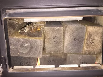

65.6lbs not counting the two small fillers.::-)

Very nice! I have began to rethink the way I split wood for this stove.The wood I had on hand prior to getting this stove was split fairly small...all of the new stuff is considerably larger...it sure lasts longer...

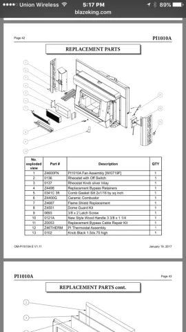

I've been reading the online manual for the Princess Insert but now that I'm looking for information about the power cord I can't seem to locate it. Can it be routed to either side upon installation, or it it fixed?

It's on the back of the unit but it's long enough to reach either side.

Thanks for that information. I couldn't find any picture of its location in either manual current or old (we're considering a new old insert). All I found was the warning not to route it under or in front of the stove. Our outlet is on the right.

Page 41 in the manual my cord is on the leftside panel.

Thank you. That diagram was not obvious to me, but after getting on a larger screen and knowing what I was looking it, I could see it. I think in this area I am spoiled by my current insert because we got to choose the routing of the cord. We can make the left work. It's just not our preference (kind of like the door hinges).
