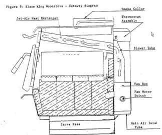

This is about the outside air kit (OAK).
Looking into the blaze king design, I wondering if when not using an OAK and using the stove with the fan on, that in somehow can cause backdraft,smoke smell that some have, and/or affect draft.
I know that kitchen hood fans,bathroom fans,etc, are taking air from inside the envelop of the house to the outside and can cause negative pressure. I am clear on that. Now, I also know that the fans in the BK, are just circulating the same air from inside and just warming it. Also I know that some cold air infiltration can be in place here thru cracks, door seals,etc making up air. Ok, understood. Looking into that the intake is between the fans, I am expecting some negative effect, if an OAK is not use. I am having hard time. Maybe i am stupid.lol;em
Can be possible that the fans are drawing air from the intake and more when the thermostat is open? causing smoke/creosote smell? affecting draft? Creating backdraft on some setups?
Let me say, that i am not having any issue but this have me thinking.::P

I can't speak for other BKs, but on the Ashford, the fan inlets are too far from the stove inlet to have any effect on inlet pressure to stove.
yeah, I think Princess and king share the same design. I am just wondering, what part of the design/engineering stopped that from happening. just curiosity.

Huh. I thought those tubes inside the stove were going to the air wash, not part of the blower system. Are there vertical channels in the front/inside of the firebox that feed the air wash?
you are right, i pick this quick from the web and noticed later something is not right but at least shows how fans and intake are. that part is right.
