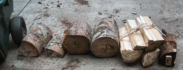

I'm in the midst of a weight test. I took six logs (shown) and I weigh them every month or so.
I'll post the full results when I'm done, but the weight has pretty much leveled out on all of them after 5 months or so. I don't know how dry they are, but I can be pretty sure that I can't get them any drier than they are now.
