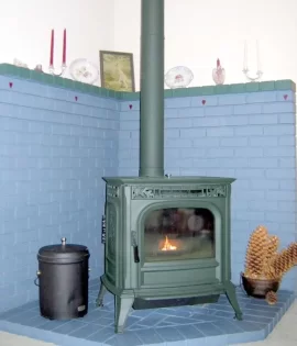

We have a rj parlor stove made in tiwian and we arent sure how to install it and could use some help i hears its kinda like a hearth that we want but yea...here is a picture of one i like and what i would like to do but i cant use brick cuz my floor wouldent support it (we have a crawl space) also i was told you cant paint them but i see them painted all the time so yea
  • [Hearth.com] What do you put under a stove
Hi gorgeous. Drop dead handsome here. Post a pic of the stove and your proposed hearth so we can see what you are dealing with.
Hate to be the one to bring the bad news, but I don't think you can legally install that stove in any way. I'm pretty sure that stove is not tested and listed. I'm sure some of the experts will chime in here and let us know if I'm on the right track.
Welcome to hearth.com, glad you're here asking questions before you get yourself into a dangerous or deadly situation.
well i dont know what a hearth is lol im geussing it goes under the stove i want it to look like the pic i poseted in the first post i will try to get some pics of the stove itself posted later today and why would it be illigal and how do i find out if thats the case? i cant find any info on it at all this is the only place i have found anything on it and there is one ppost of a lady that has the same one and cant find anything either also i did find a stove that looks kinda like it but there not the same

That said - you are looking for information on floor and wall protection - and you are correct that the proper term is Hearth....or, of course, floor protection.
Start with this article and some other in the info section:
https://www.hearth.com/articles/63_0_1_0_M1.html
Also search around in the Q and A.
If we assume that the stove is not listed, it is typical that a local inspector will either not allow it's installation OR require that the installation meet "generic" specs from the NFPA (see article). These generic specs call for a certain amount of protection based on how tall the legs are - because heat from the stove travels down based on this.
It is very possible that a crawl space CAN support a single layer of brick.....in terms of weight - since it is spread out. This is especially true if you are right up against the outside wall or a support beam in underneath - again, something for a pro or person of experience to determine.
Another generic floor protection scheme that would work with a lot of stoves is.
1. Put a sheet of 24 ga sheet metal on the floor
2. Install at least 3 thicknesses of wonderboard or durarock (cement boad) on this, and face it with ceramic tile or slate.
(use screws and possible also some adhesive or thin set to fasten to each other and floor).
Again, if you are unable to find any info on the listing of the stove or a manual, etc - you might want to think twice about installing it. It can still be used for decoration, etc. - my cousin has a few stoves like this in her house with electric logs in them.

The hearth which is the base that the stove sits on. the construction design of the hearth is dictated by the stove design. Some stoves need a very minimal non-combustible surface and others need all the hearth they can get. With an unlisted stove the hearth must be built to the maximum code protection. As the webmaster noted, your floor should easily support a layer of brick because the weight is spread out. but a veneer of brick probably will not fit safety requirements for RJ parlor stove. There will need to be an insulation barrier to stop the transfer of heat from the bottom of the stove to the wood floor under the hearth.
