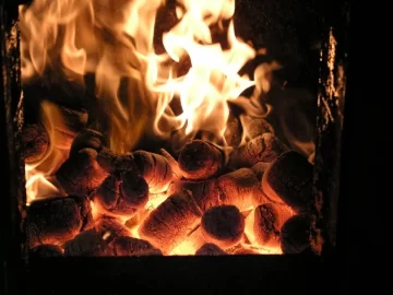

I wanted to post a picture of the briquets burning

Briquetmaker said:
