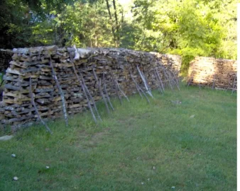

I installed a gassifier 2 years ago, and was only able to season 5-7 months the first year. I did just what Oldspark said, and it worked ok - not great but good enough. This past Winter, I better off, with 12-5 month seasoned wood. Most of it was at 20%, or just slightly over. The only thing I'll add to Oldspark's post is that split size is a big part of it - less seasoning calls for smaller splits. Now being a year ahead, I'll start experimenting with slightly bigger splits, but will probably keep on stacking open, in single rows. Here's a shot of one of the stacks from late last year. The props were done to get the stacks as high as possible - don't need to do that anymore. Processing wood this way is a lot more work, but if you're in a bind (and have the time), get moving now and you'll be ready for next Winter. After that, get a year ahead!
  • [Hearth.com] TSC says 6 months on the stack is AOK

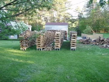

This wood was cut during the winter of 2008-2009. Split and stacked by early April of 2009. Covered around December 1, 2009. Most of it still sits there. The wood is happy and so am I. I did burn just a little bit of it this past winter but not much. It burned okay. It will burn much better next winter or the winter after that, or the winter after that, or even the winter after that.
Say what you want but this makes great firewood! Also we have an excellent stove. We burn half the amount of wood we used to and stay warmer. We also do not have to clean our chimney very often. Our present stove has run for 3 full winters and the chimney has been cleaned once. Even then, we really did not have to clean the chimney.
