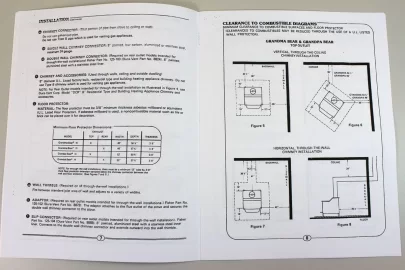

Quick update, chimney was inspected, terra-cotta checked out 100%, chimney man said doesn’t think much was every burnt in this chimney at all, cleaned it out and barely pulled any soot or debris, no cracks or flaking. So we’ve decided on the Englander for the living room ==c! I did find a very nice Fisher grandpa bear in the classifieds here...So here’s my next question. The ol lady wants to remove the Franklin and replace it with something rustic looking but that puts off good heat if we decide to run two stoves for family occasions etc here. I personally am happy with splitting and burning wood for one stove but, happy wife happy life. Are the clearance guidelines the same for all Fishers even with a top flue into lined masonry chimney? Specs say min 30” between back of stove and chimney, but they only show a rear flue setup? Iv got 48”x48” raised slate hearth in the dining room/addition and I don’t think that baby will fit in there, but damn it’s a good deal!
Did they check to see if you have the required clearances to combustibles from the outside of the masonry structure to combustible materials?

WOW..... didn't expect that to be that big ;em (I don't hear that very often anymore)
Anyways.....those appear to be to combustible materials. There are code approved methods for cutting down on those clearances.
All fixed. Thanks for posting. Use the thumbnail option for images to reduce display size.

There are several methods depending on the amount of clearance reduction needed. Here is an article on the topic.
https://www.hearth.com/talk/threads/wood-stove-wall-clearances-primer.147785/#post-1987380
And here is the NFPA table on reductions:
https://www.hearth.com/talk/wiki/nfpa-wall-clearance-reductions/
Yeah, sorry....I'm a little fuzzy on the thumbnail thing in this instance. I just copied it from somewhere and pasted it. It wasn't on my hard drive. Maybe I need to save it somewhere first next time and then add it as a thumbnail.
