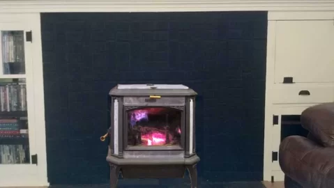

Here's a quick mockup of the PH in this location.
[Hearth.com] So many inserts... only one existing fireplace.
I think that looks good... but the lintel needs to move up. I have the owner of a stove company (Nicko's Chimney Company in Latrobe, PA) coming in about 2 weeks to go over the whole house.
A good mason can definitely raise the lintel and with that there are more stove options, including putting in a freestanding stove in another location. Try to think creatively and be open minded to all the alternatives.

Sure, a mason would be a good idea too, get an estimate, give you some idea what's involved. I'd be wanting to make the fireplace as large as possible to accommodate a nice large stove inside it. If you just put the stove in front, might save some money, rather than rebuilding it as an attractive fireplace.

I definitely have an open mind. Just don't like not knowing one way or another... I thought I could move the lintel, and was confident about busting out some brick and reclaiming them for the base... now not sure.
BeGreen's suggestion is probably your best bet, although I think a Fireview would work as well. I'm not sure if Nicko's is a certified mason. You want a specialist for this. Do you have Angie's List by chance?
