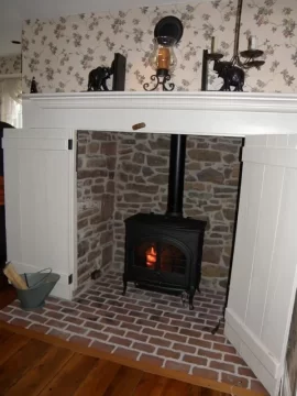

I really like Nick Mystic's rig. If I had a smaller fireplace, that's the direction I'd be going.

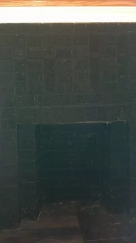

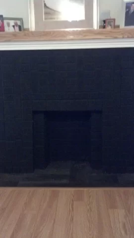

dimensions:
width: 26" and narrows down to 17"
Height: 25"
Depth: 12" (this is what worries me)
My plan is to remove brick all around giving me new dimensions of 34" width, 32" height, and 26" depth... if that can all be done.
Not exactly an ideal situation and I've never done this before, so I have some doubts, but... I need to do it to fit anything in there.
That is a super shallow and small fireplace. You are not going to fit an insert in there.
Are you sure you can remove the brick? It can't be removed arbitrarily. There is structure and heat blocking that needs to be honored.
There should be a lintel that is supporting the front face. It may show as a metal angle lip under the front face brick. Do you see one at the 25" height?
I'm wondering if you would be better off with a full hearth extension and setting a top venting stove in front of this fireplace. This would require going up 2-3 ft and then tapping into the chimney above the damper. The liner would come down to a tee at this thimble hole and connect to the stove there. The bottom of the tee could be extended to below the damper and capped to make cleaning easier. Otherwise that low opening is going to be a challenge to find a rear-vent stove with a flue that low.

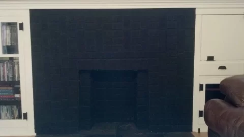

Can you show a shot from further back showing the full wall, mantel and any other nearby woodwork?
Maybe I'm just stupid... but I measured outside and then inside and am coming up with more than 30" of space, and from the inside, the chimney is only 12" deep. I was under the impression that it was closed off at some point. Perhaps, I'm wrong about that, and then it changes everything and all of my plans.. and if you look up at the lintel it is mortared over partially along with the old damper...
Looks like it was never a fireplace for wood burning, just coal, unless it was closed in at some point. Age of the house would be a clue. But chimney size should be a concern, that needs to be determined.
House was built in 1942.
I'm getting frustrated. I stubbornly thought this would be a straight fix, but now am thinking it's not going to happen... and doubting things. How stupid am I for not figuring this was a coal fireplace...
Agreed this looks like a coal fireplace, right down to the coal black color. Nice looking house there Nate. How old is it?
I would get a mason in. A pro can raise the lintel for you. That would provide clearance for a freestanding, rear-exit stove. Most rear exit stoves are going to need 25-27" clearance for the connector to the flue outlet so you are not that far off. But the larger the stove the higher the flue outlet generally. There are some exceptions and I'm starting to think that a Woodstove Progress Hybrid should be considered for here. With the short leg kit and no ash pan the top of the flue outlet is just 25.75".
