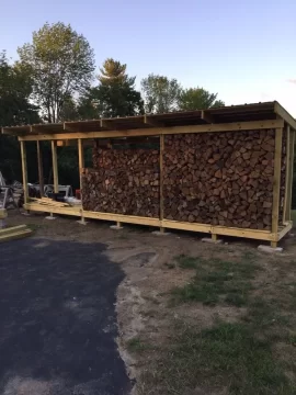

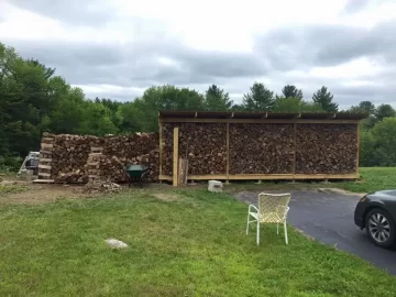

Looks good. DOnt want to be a buzz kill, but if those floor joists are only on 4' centers, they will sag under load of the wood.
Figure it will sag even with 2x6 decking?
I anticipate some settling, but no sagging.IF it sags, I will take decking off, lay in crushed rock and use pallets. I will also post any issues so others may avoid my experiance.Looks good. DOnt want to be a buzz kill, but if those floor joists are only on 4' centers, they will sag under load of the wood.
Yes. Especially spanning 4'. I have a feeling there will be more sag than settle. I hope I am wrong.Figure it will sag even with 2x6 decking?
Organized, easy to load, I refer to it as a drying rack - not really a shed.Is all that wood already seasoned? Or will it season with all the open sides? Looking to do something similar to season my wood and keep it organized

Used a screw to hold the bracket steady and used 8p to nail in. Also toe nailed rafters to header with 8p.Very nice shed!
But did you use nails or screws on the joist hangers????
