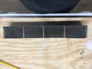

This might also be related to what I would call a warped combuster. When I took it out to clean last year I noticed it isn't exactly a rectangle. This might leave a little air pocket for the exaust to flow through without going through the CAT?
Did you take a picture at the time?
Any wood that has been split,stacked and top covered for 3 years should definitely be read. The warped combustor is a mystery. I would contact WS.
