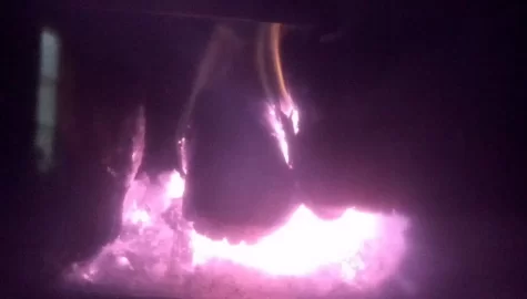

My Blaze King princess running about 350° does this look normal. ? About 6you hrs burn time.

How long does your cat stay in the active position and how high does it get?
It seems like the entire length of the burn. But slowly creeps down. It goes up on the average to 1 oclock.
That's not too bad, I assume that's enough heat for your place. With a better draft it would probably get hotter and stay hotter longer.
