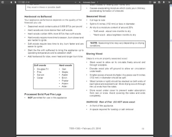

Read mine completely. It recommends only using softwoods for starting a fire and getting the stove up to temp. It doesnt say not to use softwood true, but it doesnt recommend it for sustaining a fire.
So can you show me where it says dont use softwoods or as you said only use seasoned hardwoods??? The whole pine thing comes from the fact that it dries fast and burns hot. Because of that when people ran out of the wet hardwood they were burning that had loaded the chimney with creosote they went for the pine and it lit the chimney off. It wasnt the pines fault. It was the wet wood burnt previously. But the soft wood got blamed because the chimney fire happened when burning it.
I think that's the wrong interpretation of the tea leaves. All the manual says, or at least of what was shared, is these are common woods for best results and does so for both hard and soft.

From my manual. If you wish to squelch open debate then that is your prerogative, Sir.
Yes i read your manual and it in no way says soft woods are unsafe in any way or that they should not be used. It simply is not there.

That does not say or imply that softwoods are not to be used. Or are 'crap'?
Says to start the fire and get up to temp. If you sustain a fire with dry softwood you will either have a rager, or choke it down and get creosote. My term is crap, and always will be. There is one time I would sustain a burn with pine. That would be after I had burned all the hardwood furniture in the house and had nothing left to keep from freezing to death.
