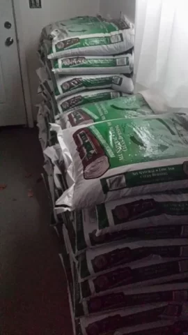

Hopefully this lasts me for a while...

the stalls are because you can adjust the the blower settings for each individual heat level. those are pro pellets correct, herd they are decent pellets

Yeah Pro Pellets. We have a Fireplace store about 13 miles away that carry 100% oak (no bark) pellets for $250 a ton and they swear by them but TS is right down the road and I figured I'd try their stuff first since it's close.

Stove's running great. I'm starting to have mixed feelings about the Tractor Supply pellets. I seem to get lots of ash and dust now that I'm running it longer. I'm going to switch to Agway's pellets since a friend of mine said they are way better (her father is a stove seller). We'll see. I got about 22 bags left before I can get another ton.
