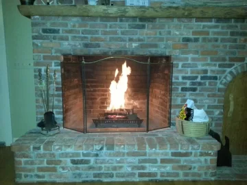

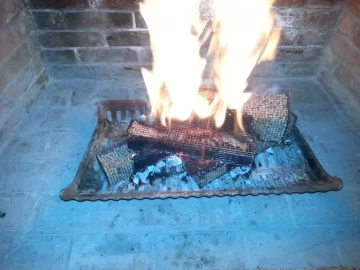

pellet cages in the fireplace. I first used all 4 and the flames were quite high. there was about a 2" high rolling smoke layer above the cages and the flames came from those. see pics, the rolling smoke didn't come out so well. in an open FP the logs burnt out really quickly. less than an hour. It was better when I used two logs at a time, but still the long skinny flames lept from the log. This is a large FP with excellent draw in this FP, so maybe thats it. So far the best use for me is the wood stove, havn't tried to cook with it yet.

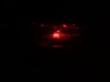

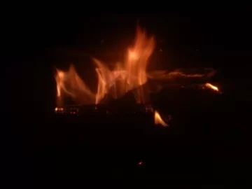

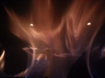

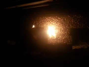

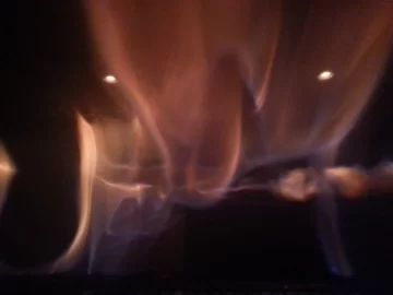

Ok, so I finally got a chance to test all four cages at once in my larger stove. For the first
1/2 hour it puts up long thin flames straight up onto the burn tubes which heat up the stove nicely.
At about 1 hour, it started this rolling waves of flame (see pic 3) this went on for about 1 hour or so.
This was mesmorizing, I couldn't stop looking at it. A good show.
Keep in mind that throughtout the whole burn, except for the first 15 minutes, I had the air lever
all the way closed. After that it started the die down process but all four cages still contained red hot
cores. Lat checked it at 11:30, probably continued the burn out process for maybe a hour after that, but
with considerably less heat output.
I was relieved to see that the flaming from all four cages could be contained using air control.
Also, there was a significant amount of blue flaming.
So a 4 hour burn is not ideal for all situations. But for shoulder seasons or when you want a fire
for the rest of the night till bed time, its a good option. It was also fairly hands-off. Wide open for
the first 10-15 minutes, then closed all the way, before going bed I opened half-way.

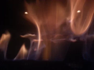

7:30 PM - Lit 'er up. pic 6
8:00 PM - 212d picture 5
9:00 PM - 487d pic 3 -5
10:30 PM - 452d pic 1
11:30 PM - 200d
Reactions: Soundchasm
