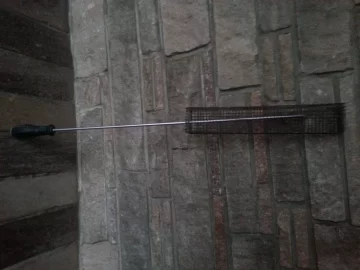

Picked up this set for $4 at HFC. Works well, skewer the cage, shake out the remaining few pellets, remove. Cage is room temp before you can find a place to put it.
