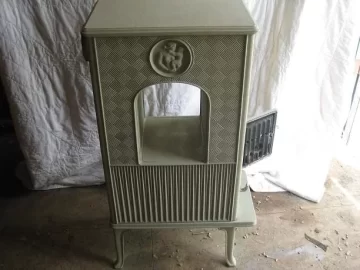

I painted my Jotul 606 with Stove Brite and it turned out great! First I sandblasted it then painted it with crappy Lowe's paint, then started over and painted it with Stove Brite. The difference was night and day. But I don't think you can ever match a factory finish.
  • [Hearth.com] paint question

Webby, stove looks great!
