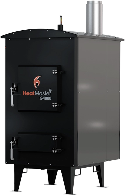

Looks like MSRP on the G4000 is $8,995 compared to $10,170 for the Wood Master. I’ll have to see if there’s any dealers around and see if I can lay eyes on one of these.
The G4000 firebox and water capacity is significantly smaller. Not sure how that’d play out for burn times.

Just spoke to the local Heatmaster dealer and he says that for my situation (1,800sq ft moderately insulated rancher), the G4000 would be more than sufficient. He is currently running that stove at his house (4,100sq ft worth) and has gotten 14hr burns during some recent cold spells of 15-20*F. Crazy to think considering the 8.5sq ft firebox and 116 gallon capacity. Either way, price on the G4000 is $8,995.
