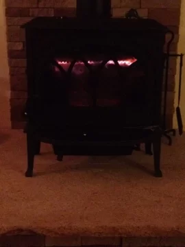

if i have hot coals, i dont need to give it much more air. maybe im just playing with the damper too much. i feel my wood is as dry is it can be for the amount of time it has sat. its going to be warmer tonight so we are letting it burn out. i will clean the stove and give the chimney a look.
this is how it looked last night

What is that floor material under the stove?
Ok:) on my phone it looked like thin carpet! I see it now.

under the stone is 3 1/2 sheets of wonder board on top of plywood. i may be installing the bottom heat shield . the granite hasn't been even warm but i don't think i will take any chances
I wouldn't bother with a heat shield on the bottom since so little heat comes off the bottoms of most stoves. What heat does come off your stove will get sucked up by that granite and come back to you later as the stove cools down. No way do you need to be concerned with the setup you described.
