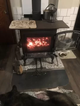

That's our setup right now, just burning down some coals.

I let the stove burn out today and I tried the start up you suggested in post #66
Start up was the same slow, had to leave door open for almost 10 minutes before it would stay going on its own.
Even with air supply wide open it seems as if it’s struggling to really get going. I would expect more I guess
But maybe that’s the nature of this stove?
I know my wood is good, if I open the door it will take off and be a roaring quickly.
I tried to figure out what kind of pipe I have today to order another 3’-4’ extension but it’s nothing I can find local.
I’ll attach a pic of it.
[Hearth.com] New guy here with a few questions. [Hearth.com] New guy here with a few questions. [Hearth.com] New guy here with a few questions.
It looks like that might be MetalFab chimney pipe.
The chimney will need a roof brace at 5' above where it exits the roof.
Reactions: wasatchcomm
