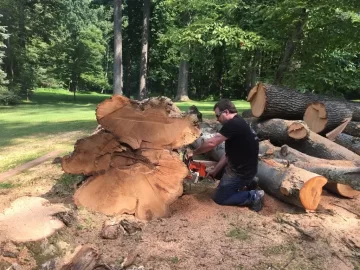

Roll them off the pile onto the ground, cut 90% thru all the way down the length of the log, roll half over, finish each cut. It's the way every person who has cut more than a few cords eventually comes around to doing it, learn from their experience.
The only time I wedge to finish is when a log is too big to roll, like this one we cut ten days ago:
[Hearth.com] Log Load On The Way
