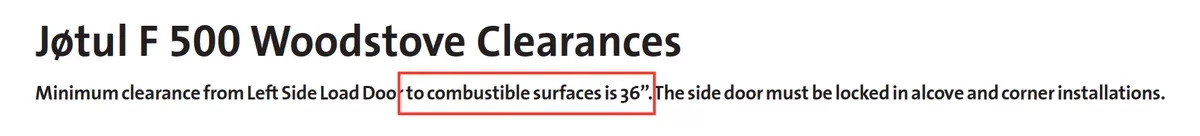

It would be ok if she has the lock kit and uses the front door for loading or the wall is made from non-combustible materials. However, it is more likely that everyone involved just missed it. (Except for jotul8e2 but his post got overlooked: https://www.hearth.com/talk/threads/shes-here-yet-another-oslo-install.139631/#post-1876537)

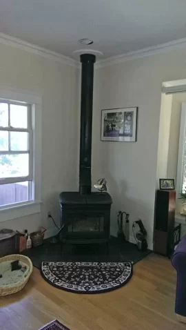

It seems that this stove would be 100% good to go, if I did NOT use the side door. Correct? (Obviously extending hearth our front etc)
it looks like walls are drywall. Not sure how they could possibly be non combustible.
Even if front loading only, it would appear that there isn't 36" of clearance though on the sides. Or is that 36" only when you are using side door? (Sorry a lot of info to digest here)

Yes, that is correct but you should have the side door locked with Jotul's kit to pass inspection. However, loading the F500 from the front is a major inconvenience. I would really think hard about buying another stove then. Did you at least take a look at some of the other options I posted?
Only when loading from the side. If you lock the side door the corner clearances I posted of 9" or 6" from the back corner of the stove to the walls go into effect.

Guys- I've ran into this install so many times- from the pictures, an Oslo is a no-go. You do not have the required side wall clearance to operate the side door. If you want an Oslo, you will need to lock that side door, defeating a prime reason for having this stove. I am the last one to try and tell people what to do, but in your scenario, we have turned down sales for the indignant customer who will "Install it anyway, no matter what you say or the manual, its my house." They are correct too, it is their house. I try to fall on the safety side, not knowingly let someone do something they should. Jotul's number is still the same, you can use 800 instead of the area code. They are going to tell you the same thing though, its in black and white. There are too many nice stoves out there that will do the job greatly for you, rather than risk injury to anyone. But Jotul's answer and the store I work at is its just not worth the risk. I also agree with the crowd here, front loading an Oslo would be no fun and would lead to frustration. Good luck with it, Jotuls are great stoves, but so are many others.

Those clearances look even tighter than mine though. What do you have on the walls? Just drywall? That's the part I don't understand. A stove right up against a regular old wall is fine, but you need 36" just to open a door for 5 seconds to load wood. HAHA
Yes just drywall. Stove designs vary a lot and thus do their clearance requirements. The Alderlea is a close clearance convective stove. The cast iron is a jacket with an air gap between it and the firebox. That dramatically reduces clearance requirements though for this installation the actual corner clearance requirements are exceeded. Note that this is a front load only stove so side clearances are naturally going to be closer. The Castine got the side walls fairly hot, around 150-160F if it had been running hot for a long time, like during cold weather. With the T6 the walls are now notably cooler.
Obviously you and I am sure many others already know this. But, this is Jotul's logic.
You can have that stove as a FRONT LOAD stove only in a corner install, if you so choose, and the stove can be pretty much right up against the walls. I believe anywhere from 6-9" away. And there is ZERO issues at all with heat, etc. But, if you then want to use the side load door in a corner install, you then all of a sudden need 36" of clearance. The door is literally open for all of what, 5 seconds at a time to load wood, and you now need 3 feet of clearance? Is there more heat coming out of the door while opened, compared to it not being opened? Of course. Not a whole lot, but obviously some. Does that mean you now need 3 feet of clearance from that side door? I'm not so sure I agree with that. As long as the side door can swing ALL THE WAY open, and you can load wood safely, there should be ZERO issues at all with using that side door. I think Jotul went full retard on covering their asses.

Yes just drywall. Stove designs vary a lot and thus do their clearance requirements. The Alderlea is a close clearance convective stove. The cast iron is a jacket with an air gap between it and the firebox. That dramatically reduces clearance requirements though for this installation the actual corner clearance requirements are exceeded. Note that this is a front load only stove.
I'm just surprised it can be that close to the drywall. THAT would make me more nervous, then not having quite 36" of clearance for a side loading door. Does it ever get hot? The drywall?
Your experience is with a radiant stove. The Castine (also a radiant stove) got the side walls fairly hot, around 150 -160F if it had been running hot for a long time, like during cold weather. This was in spite of the clearance for the F400 being exceeded by a couple inches. With the T6 the walls are now notably cooler even though it only exceeds the clearance by an inch. They read about 130-140F typically.

Not sure what I will do yet. Most likely use the stove as a front loader for now, that way I have the stove we want. Because down the road I can always make changes to my hearth to make it work. I will agree to disagree with a few people though on here that you NEED 36" for that door to be open to load wood for all of a few seconds. makes no sense, and they went to the extreme it seems.
I am about to put an Oslo into the right corner of the living room of my new log cabin. Jotul obviously has got some chicken lawyers with that 36 inch rule on the left side, and I like to break stupid rules.
36" is to the nearest combustible. If the left side-wall was changed to be an NFPA ventilated wall then I think it is a pretty safe install, even if the back of the door opening is only 16-17" away from the protected wall. An NFPA ventilated wall merits a 66% clearance reduction or 12".
This is not just Jotul. The 36" clearance from combustibles applies to front or side doors of all stoves.
Simonkenton, this is not just Jotul. The 36" clearance from combustibles applies to front or side doors to all stoves.

I forgot, but Jotul did call me back today. A sales rep of 25 years though, not their tech department. He said 36" period, and they aren't allowed to budge on that 1 way or another whether they think it's OK or not. I got the feeling that he wanted to say, "yeah it's fine", but obviously he isn't going to say that.
He said that whatever their dealers wanted to do, is up to them. But as far as hearing anything else from Jotul it won't happen. The manual says 36" and that's it.
