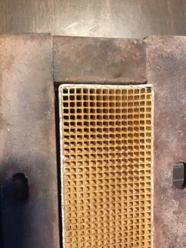

I have a HighValley 2500 insert that came with my house.
After learning about the model I tore it apart to find the catalyst to be broken into many pieces.
I bought two identical catalyst and gasket material to replace it.
I question the outcome so I reached out to:
1) HighValley Stoves parts with no reply.
2) A distributor with no reply.
3) The company that owns HighValley Stoll aid they sold the company to
Suppertime Stoves: Phone: 800-626-2249 Email: [email protected] Alternate email: [email protected] Alternate phone: 519-878-3728
I don't recommend HighValley at all.
Why sell something with no specifications or support?
I simply need to know the proper gasket size for the catalyst?
There is an 1/8th in play all around the catalyst.
Thank you for your help
HighValley catalyst called part CATUNI is
2.875'' x 6.875'' x 2'' Catalytic Combustor Replacement
NLE5SA_3472
My Cats are broken to, i've always got parts from (broken link removed to http://www.highvalleystoves.com/stoveparts.php), broke the door glass last December and got a replacement from them with no problems. For the cats i will get them from http://appliedceramics.com/. They got the cats and you just buy a roll of the gasket material and cut off what you need.
Reactions: Gooberdoober
I have a roll of gasket material around my CAT, there is still has another 1/8 play all around it the CAT once installed
IIs that normal?
The interam gasket material swells to seal gaps when it gets hot. I'm pretty sure it would cover the 1/8" of play but I'm not absolutely sure. You could cut the gasket long enough so it would cover two of the four sides with two layers of gasket...
